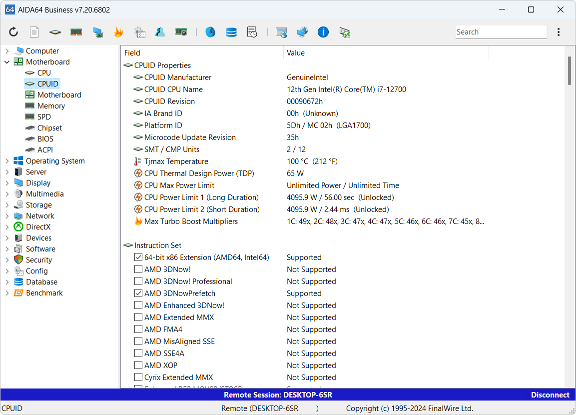

AIDA64 can provide detailed hardware and software information from remote computers. To access this information, you can double-click on the remote computer in the Connected tab or right-click on it and select Remote System Information from the context menu. During the remote connection session, the details of the remote machine will be displayed in both the Page menu and the information window.

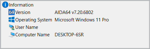

When you click the name of the remote process, you will get basic information about the remote PC. If you need to terminate the connection, you can click the Disconnect button on the right-hand side.
A notification bubble will appear above the notification area on both the local and client computers to inform the user about the success or failure of the remote connection attempt. During the remote session, the AIDA64 icon in the notification area will turn red. To hide the bubble notification and the icon, you can use the /SILENT command-line option.
